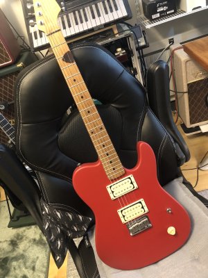

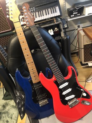

You can put a 24" Warmoth Mustang neck on their 7/8 Strat and/or 7/8 Tele bodies without any modifications.
I have 2 such Strats and one Tele and they play perfectly. No "special" bridge route necessary.

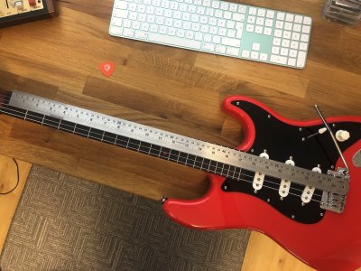

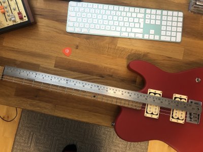

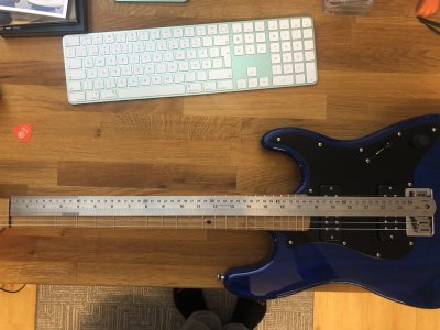

And I showed you three of my guitars that are 7/8 ones all with 24" Mustang necks - so, yes, it works.
But if you still won't take mine or Stratamania's word for it, here are some pictures of these guitars with a ruler on top of each.

None of them are modified, they are just "ordinary" 7/8 models and the Mustang necks are Warmoth's "ordinary" Mustang necks.
No magic, nothing strange, they just work, like Warmoth (used to) say on their website.
