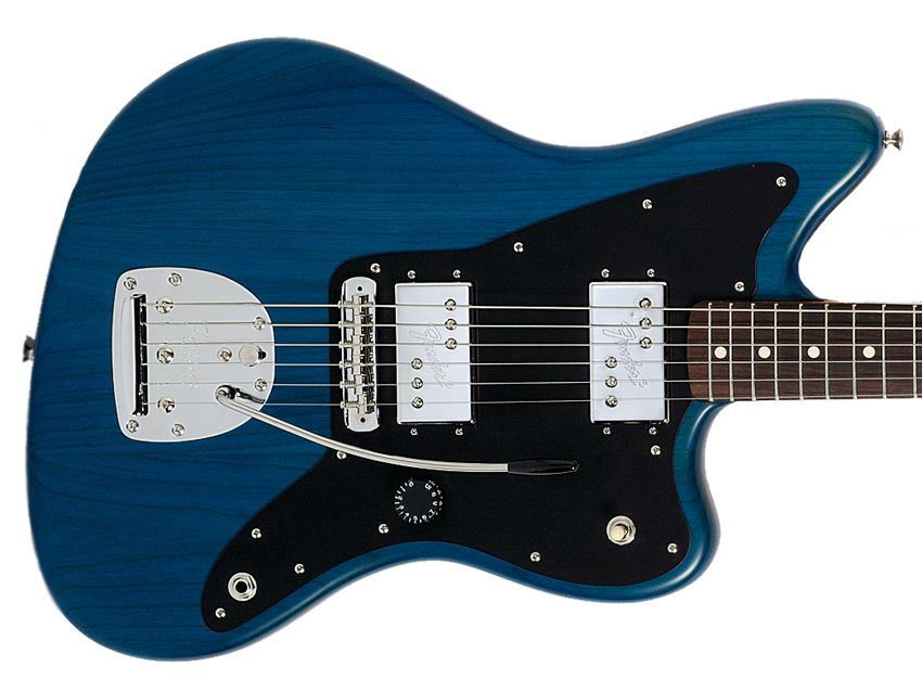

For WRHB it looks like you'd recommend the Fralin's? Just wondering why WRHBs?
I bought a set of the Fender CuNiFe reissues but yeah there are several folks out there making cool takes on WRHBs.
I have never played "real" WRHBs being the CuNiFe vintage ones or others that use the magnet pole pieces but on paper Wide Range pickups are described as sounding "fat" but with improved clarity and detail over Gibson humbuckers. Which after watching a bunch of videos on them, I need to at least try them.
Plus the Lee Ranaldo Jazzmaster always looked awesome to me.
Also side note, I had emailed Warmoth's customer service and while they dont offer a route in the body, they can cut a pickguard for WRHBs for a small upcharge.

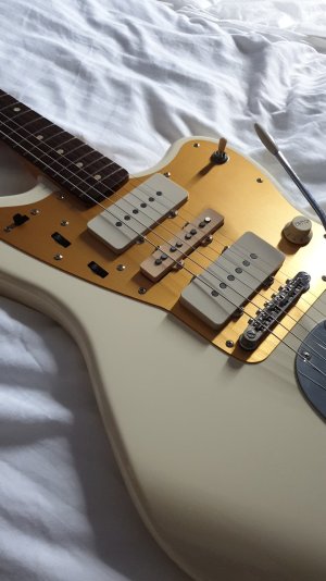

While I had a luthier do it for me, you could always go off the beaten path and drop the *other* kind of JB pickup in it!
The one you see above is a Kent Armstrong pickup, flanked by two SD Antiquities, that I got for a low price that I can't recall (cream cover sold separately). If I were able to procure it without having to buy the whole thing, I would have put the Epiphone Century reissue blade pickup (which is ALSO a Jazz Bass pickup) in there instead, but I'm quite happy with how it looks and sounds. It's wired like a 3PU Les Paul Custom, so the middle position uses the pickup in an out of phase kind of way. Bit of a Position 2 on a Strat, but on steroids. Or a very muscular duck.

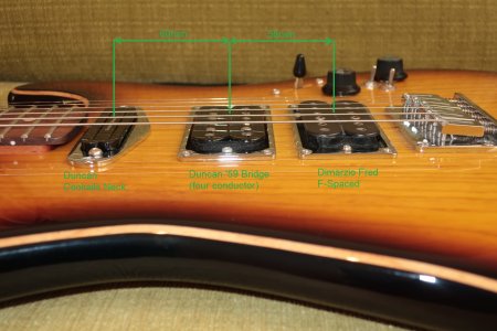

I only have experience with one triple humbucker guitar, although the neck is a single sized rail pickup as shown in the pic. After some experimentation I settled on the Duncan Coolrails neck, Duncan '59B in middle position, and Dimarzio FRED in the bridge. I tried other pickups such as Suhr SSH (standard 14k wind) and PAF PRO in the bridge, but they didn't sound as well balanced as the FRED. PAF PRO was too bright, but it could be because I routed the location for the bridge humbucker closer to the bridge than where Warmoth normally place it. I tried some other neck pickups including Dimarzio Satch Track, but that was too warm for what I wanted. For middle position I found the Duncan '59b to be ideal and I haven't even considered changing it. It is bright enough to sound balanced yet clear, but I often use the tone control to fatten it slightly. Although the middle humbucker is mounted very low, the output is strong enough to combine well with the other pickups in the notch positions. I'd suggest to get the optional 4-conductor wiring so it can be coil split or switched to parallel connection.
I would probably favour having 3 full size humbuckers, especially if you want to do coil splits. With the cool rails neck, I have tried coil split wiring but I didn't think it was a useful tone.
